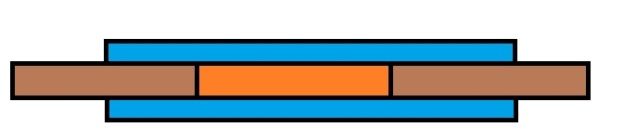

Sure, cut out all the bad, Fabricate the replacement piece so it fits in-between. Coat it wth 3 coats of epoxy then sister it in on bothe sides using deck screws. Tab it all in with glass and you're done. Something like this...
Top view..

thank you i was thinking i had to do something like that but i wasnt sure.
