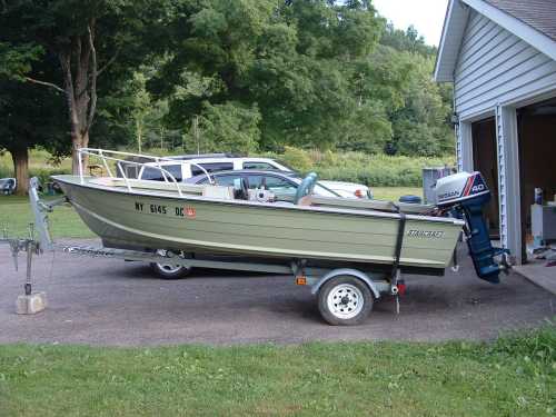

I'm betting your boat looks more like the pic above, but if it looks like our '67 14' starcraft, it will take up to a 40hp.
