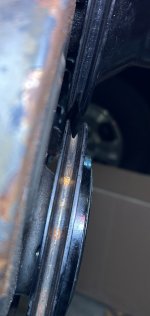

I’m not sure if my harmonic balancer is on all the way. Can anyone confirm this via pictures?
E Eyesbrand Recruit Joined Oct 28, 2023 Messages 1 Oct 28, 2023 #1 I’m not sure if my harmonic balancer is on all the way. Can anyone confirm this via pictures? Attachments IMG_1515.jpeg 650.3 KB · Views: 11 IMG_1516.jpeg 710 KB · Views: 11
D dubs283 Vice Admiral Joined Jul 27, 2005 Messages 5,343 Oct 28, 2023 #2 Regardless of it being on all the way the balancer is junk. Hub looks destroyed on one side and appears to have been beat on a few times
Scott Danforth Grumpy Vintage Moderator still playing with boats Staff member Joined Jul 23, 2011 Messages 51,873 Oct 28, 2023 #3 Agreed, get a new damper and use a damper installation tool
