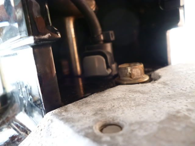

He3lp please; Quick connect on the new Alpha 1 lower leg is not connected
glastronomic
Seaman
Feb 9, 2011
72
Dealer has installed the engine and leg and I have been taken this new rig out on the water.
When I adjusted one of my transducers I did see a quick connector being plapping in the wind between the lower leg and the lower gear box on the front of the leg.
My question is should I leave this or connect this and will the gearboix be full of salt water due to this not being connected.
I have been sdudying the engine manual but cannot find any reference to this!

Re: He3lp please; Quick connect on the new Alpha 1 lower leg is not connected
To me it looks like a breather hose/connection for the lower gearbox, hence my question
here a picture of the connector reconnected by me.
That's the connector for the speedo. If you run a dash speedo you can use the pick-up in the front of the lower gearbox... Which dealer did the installation?
Thank You!
Checked the gear oil and all was good, no seawater in gear box!
I do not run a dash speedo , just a GPS through the electronics on the screen.
