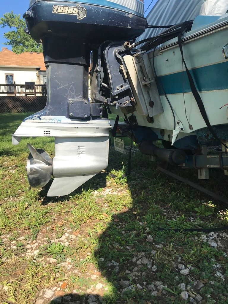

The prop shaft is about 6 1/2” below the pad. It is a 6 inch manual jackplate.

3ce4e207-0472-49ea-81e2-ccacf24dbec9
Faztbullet
Mar 2, 2008
15,931
(1) Take the tuck out of jackplate as its killing you positive trim. (2) Is that a Shooter or Stiletto 4 blade? (3) Need to come up about a inch but need water pressure gauge to go higher.
It is a Turbo prop 24 pitch. Should the cavitation plate be even with the pad?
