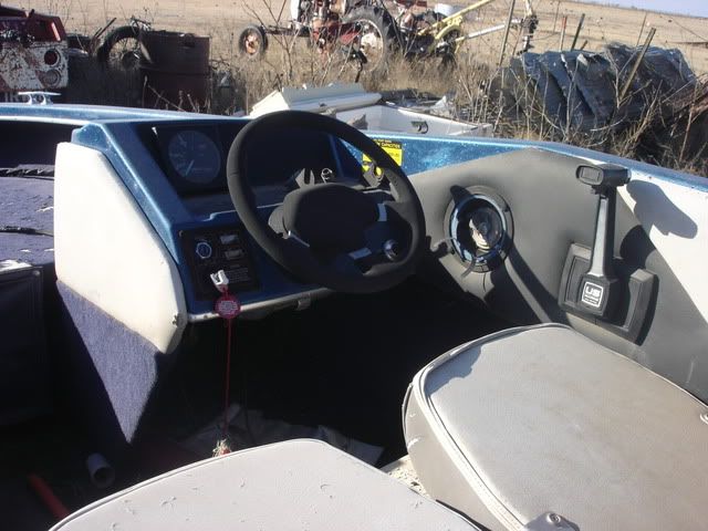

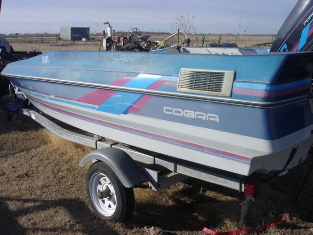

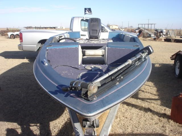

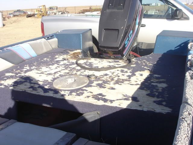

Here are some pics of the boat. Can anyone tell me exactly what it is??
ezmobee
Mar 26, 2007
23,767
Re: HELP the IGNORANCE 1988 Bayliner Cobra Restore
It's exactly what you said it was. An 80's Bayliner Cobra. It's basically the lowest-end Capri with casting decks built on it.
Please resize your pictures to 640x480. You can do this with one click in photobucket.

Okay I decided to tackle the casting decks first. Keep in mind I am not going for a show boat here just want to fish a few(10-15) times a year. Can I use treated wood and not glass it? Can I just tear out the old deck and build it with treated wood. Also, do I need to address the oxidation on the bottom of the hull? I can scrap it with my fingernail.
thrillhouse700
Aug 5, 2009
778
You CAN use pressure treated also known as PT here and not glass it if you want. Just be aware that PT plywood warps like a mofo. I would just forget about PT and buy some bc grade exterior ply thats as straight as you can get it and encase it in fiberglass.
Break it down like this, PT will need to dry for 2 maybe 3 weeks before you can glass it, if you don't fiberglass it it will still be more expensive than BC grade and require coated screws.
BC grade plus enough resin and fiberglass will prob only be slightly more expensive than the PT but last a lot longer. This is just my opinion.
As for the gelcoat you can wet sand gelcoat back to life. If its paint you might just have to repaint.
