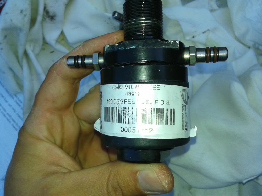

Well when I went to pull my bad injector, I noticed that it had an entirely different part number then the spare injector I purchased. The spare is 439127 which, to my knowledge, is the only part number for the 97/98 injectors with the opposing fuel inlet/outlet. All of the injectors on my motor have the part number 438967. In addition, the spare injector has under the part number "120 degree fuel PDS". The injectors on my motor read "90 degree fuel PDS". Overall the injectors look almost identical except for the near the pintle, where the taper of the injector base is slightly different.

I have included two pics below for reference.
