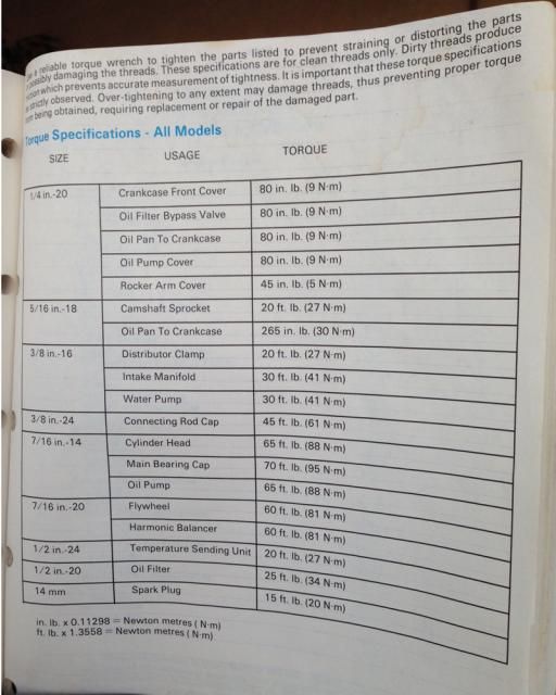

Here are the specs, from the omc manual mine is a 1986 also so the manual is for a omc and is a omc manual.
Howard Sterndrive
Nov 5, 2008
4,603
and it looks like those specs are for clean dry threads. If you have oil on them or any other fluid (including uncured loctite), you need to reduce torque.
