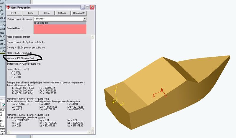

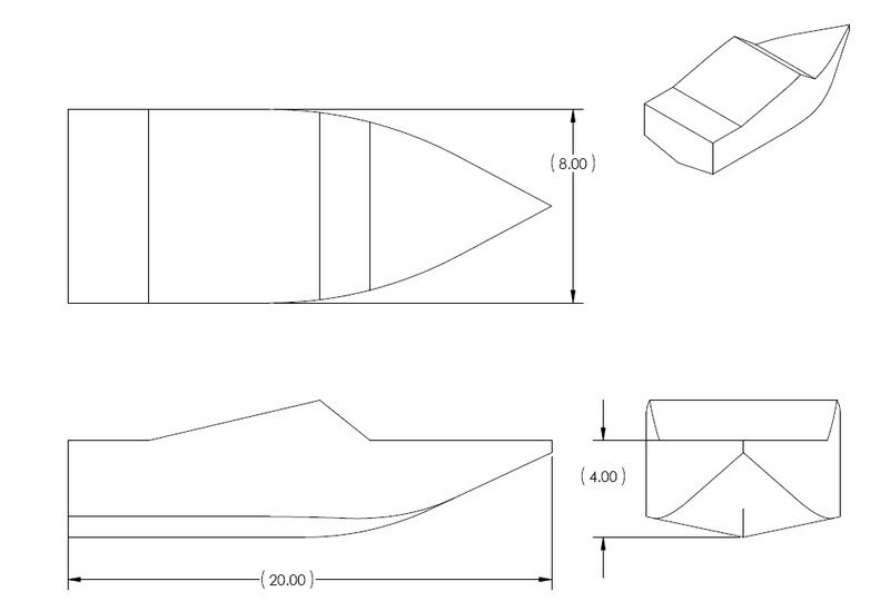

10 minute CAD model of a 20' long, 8' beam bowrider with a tight fitting cover:
Somewhere around 1/3 of that internal volume is probably occupied by seats, engine, hull, equipment, gas tank, console, etc. Free air space is probably somewhere between 300 and 400 cubic feet.....
Note that if your boat was solid aluminum (169 lb/cubic foot) it would weigh over 40 tons!!

10 minute CAD model
I was thinking of you when I posted that . . . :D
You are amazing!! I was just gonna start a thread about this . . . scratch that for my new race boat plan . . . Damn it!!! :mad:
