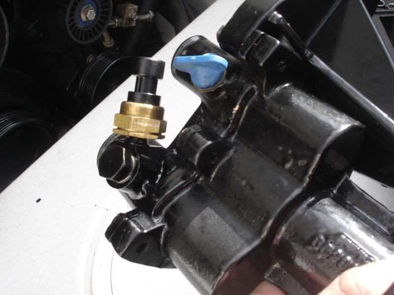

Re: how mucher water pressure does an i/o produce?
The water pressure tap on my Bravo (belt driven seawater pump) is on the output side of the pump, reading the feedline pressure just like the OP is proposing. It reads 25 PSI at about 3000 RPM and 8 PSI at idle with a brand new impellor, drops to about 15 PSI at 3000 and 4 PSI at idle after the impellor is a month or so old. A 2 year old impellor also reads 15 and 4. Never had one older than that, I change it every other year.
I would expect the readings from the Alpha to be similar.
