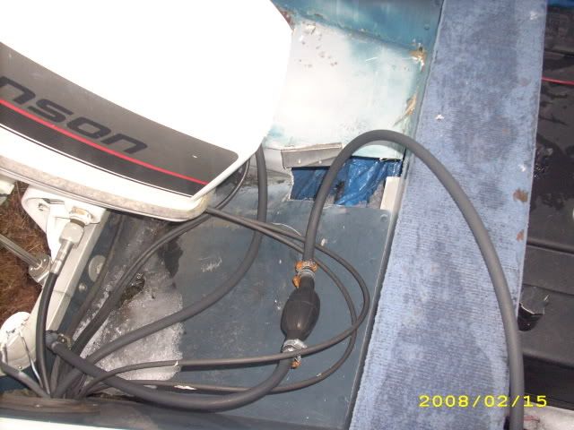

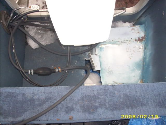

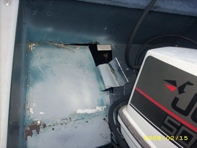

Hi everyone, Here is my problem. I bought this boat. The previous owner decided to install a larger gas tank, but in order to get it to fit he cut the area where the motor is mounted. Sorry I don't know what this area is called. If someone could let me know what it is called that would be great. Anyway, what would be the best way to fix this? If I make it match the original side then the gas tank won't fit, but I would really hate to leave it like that.
Should I cut the flooring out where the gas tank sits so it will sit lower in the boat? Then I could make it look original again? What do you guys think?
Here is some pics of what i'm talking about
Thanks guys

ok the thingy the motor hooks on is called the transom....and the area that is cut is called the splashwell.......
man... i cant beleive he did that.....:(
loose the over sized gas tank....and just put another one in the area under the splash well called the bilge.....
in order to repair that area... youll need to fiberglass it....dont panic...its easy.....cost you about 40 bucks and it will look the way its supposed to....
just read around this form (restoration) and youll see lots on fiberglassing

oops, it is an aluminum boat, either loose the big tank, or have someone (tin bender) make a cover for the area, seal with 3M 4200, and rivet in place.

Tashasdaddy, you think I should just fix what he started??? It wouldn't be very hard, I work in a machine shop and that fix would be pretty easy. I just didn't know if that type of modification was ok in that area of the boat.

that area isn't really a load bearing area. There is transom support right under the middle of your engine cover there, that's the support in that area. The rest of that is just for keeping water out of the boat.

force...its your boat...
what kind of look do you want.....it wont hurt to have the can there...if its strapped down.....but in case of engine fire....i wouldnt...
but also that splash well is there for a purpose.....some times on rapid de acelleration or rougher water, a large wake can come over the transom area and into the splash well...with thoes cuts...it will fill the bilge in a hurry...no major problem if you have a pump....but that splash area is there for a reason....
...imho....i dont know if i would want a big ol can o gas riding up there....i personally like everything below decks..secure...
it sounds like you have the resources to do what you like....your wishes..and imagination are the only limits..:)
