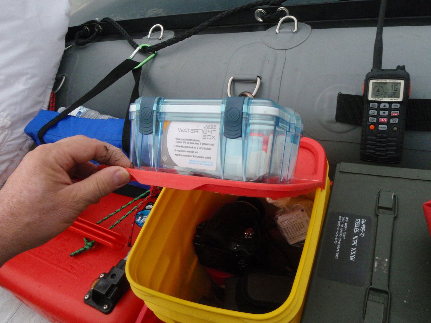

Here's another Youtube video with slightly different arrangement in boat for fishing. The milk crates and cat litter pails work good.
Took some heavy duty industrial velcro (sticky back) and put a little water proof container on top of the cat litter pail to keep track of hooks/lures. The battery holds the milk crate down for strikes and will be used for future electronics and or trolling motor?

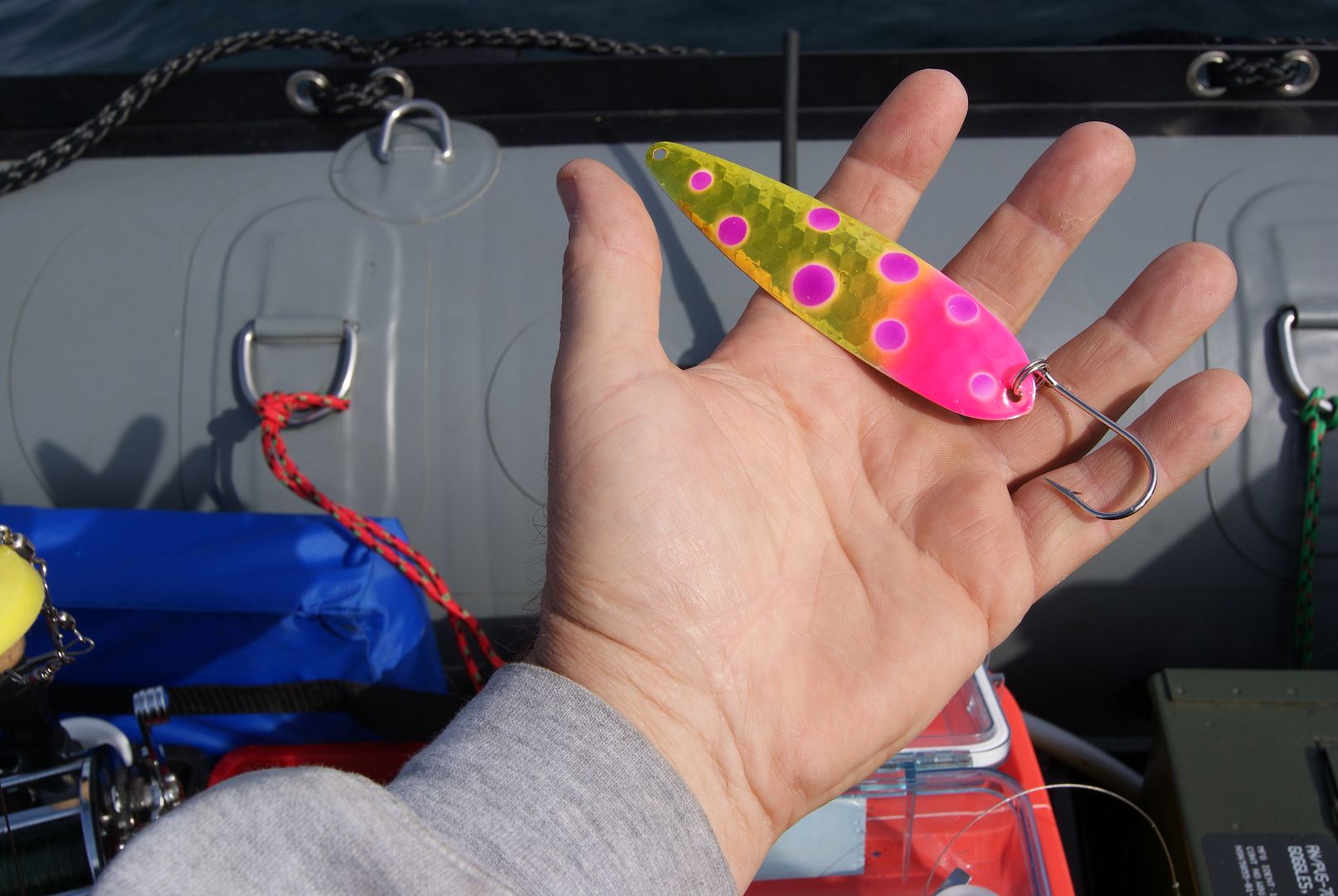

I've decided to go with single hooks on my lures too instead of treble hooks to lessen the chance of snagging a tube.
