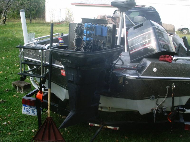

how would i tell what year my force 90 is if i have no serial number or sticker on it?heres some pictures to help out

Difficult to tell without a model and serial number, but judging by the decals and engine hood, it is somewhere between the late '80s to early '90s---say '88 to '92

That looks really close to mine..which is a '90. I'd narrow my guess down to a late series '89 or perhaps an early series '90. Just an educated guess.

Re: how to tell what year
The first year for the 90 hp was 1990.
Yours has the blue coils and cd modules which were only used on the 1990 thru the 1991"c" models.
Starting with the 1991"d" models, the coils were black, and they used a switchbox instead of the cd module.
Also, mid year 1992 they switched to a square fuel pump. You have the earlier round 2 stage pump.
So your motor is between a 1990 and a 1991"c". Since the hood/cowl still has the US Marine logo on the back, and the "CFI" on the back, I would bet a steak dinner that it is a 1990 model. All parts should be the same.

Roscoe: You got me to wondering because my so-called 1990 90hp does not correspond to your description. Got it real cheap and year wasn't an issue so I just took the sellers word that it was a 1990.
So, you got me to thinking and I went down to look for a model number. There was no aluminum plate on the lower housing BUT on the starter motor mount there was a small paper decal with the number 906A90C.
Does this mean that it is a 1990 "C" model?

Yes Frank, 1990 version c.
That appears to be the model number for your motor, if that is the original starter motor.
Number indicates it had the decals to match the Maxum boats.
What differs on your motor?
Perhaps some of the parts are not original. ?
