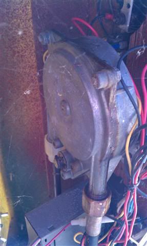

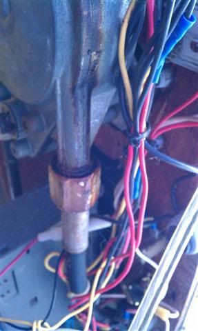

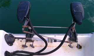

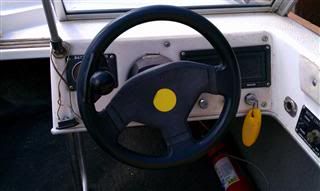

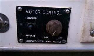

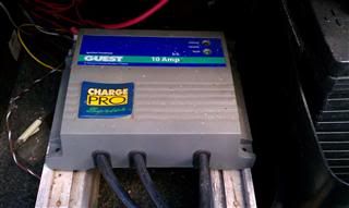

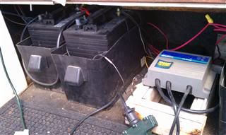

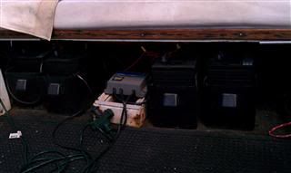

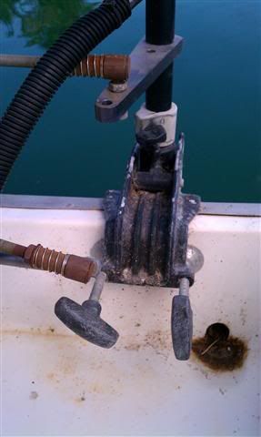

The owner of the electric boat did respond to my request for pictures of his setup. I am attaching those pics here for reference:

The picture of the steering linkage is pretty straight forward. It appears that the parts used to construct it would be available at any commercial HVAC supply house as they are the same as are used to control dampers and valves. Without know exactly what motors he is using I am not sure how it is wired.
