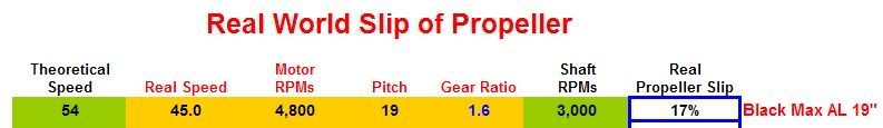

Allright....got out today and found out that the speedo on my boat is NOT EVEN CLOSE.
With 2 people (Approx 400lbs) and about 20ish gallons of fuel, I topped out at 4800rpm WOT and GPS'd at 45mph.
Hope this helps you.

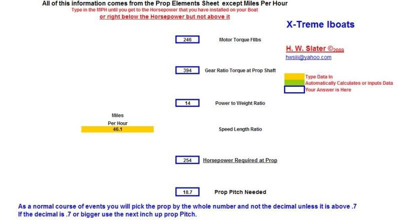

Chris, I would say you are doing very well with that combination at 2,200'. You prop slip is only 17% with that last run. In my opinion I would buy either a stainless steel 3 blade or 4 blade prop since you do some tubing and it should bring your prop slip percentage down. I will give Dhadley or Kenny some time to chime in on this and make a recommendation on exactly which prop you ought to buy, since I have found out their qualifications with props. They are years ahead of me in making those type of decisions. Hopefully we can get one of them to tell you which prop would best suit your needs for your uses. Here are the numbers I have.
