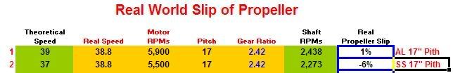

Les, I found your gear ratio to be 2.42:1 and WOT RPM to be 6,000 RPM, please verify this. Using these numbers I find that your prop slip with the Aluminum prop is 1% and with the Stiletto it is -6%, these numbers are not real but they are what we have to work with. But they are relative to eah other and they show that the Stiletto prop definitely has less prop slip than the aluminum prop. Here are my numbers.
Prop Slip
Now what we need to do at this stage is take the hydrafoil OFF and raise the motor 1 noth at this time. Then take the boat out and get me some numbers of speed and RPM starting at 3,000 RPM going to WOT in inrements of 500 RPM and lets see how the prop is doing raised one noth and without the hydrafoil. While you are doing this trim the prop up and make some halfway aggressive turns to see how muh ventilation the prop is reating so we will have an idea if we an move the prop up another noth or not. We should get an inrease in RPM and speed by doing this and it will let us know what else we an do.
