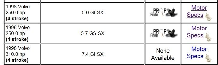

Nate, this is the information I found for your motor.

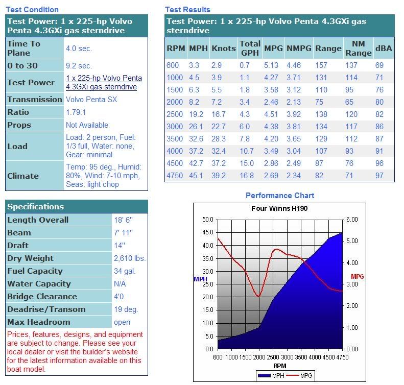

Here is the Boat Test Report for your boat, except you have 255 HP instead of 225, and the test results, and you appear to be running about 48 MPH which is to be expected with the extra 30 HP. And I will tell you these test are usually optimistic, because they do not have any of the normal excess gear most people carry like ice, food, drinks, USG equipment and all of the other paraphernalia we usually carry on our boats. And if I remember correctly you are not running at sea level which also reduces your available HP.
Boat Test Report
The RPM a particular motor turns is the deciding factor if a particular prop will work within the recommended manufacturers WOT range on any particular motor, assuming you are using the correct blade geometry for that boat.
Finding a better prop for a boat is directly proportional to meeting the manufacturers recommended WOT RPM, in almost all cases. That is the FIRST guideline for finding a better prop, then you have to find the prop that is a better fit for the correct blade geometry needed to get maximum performance for your particular uses and needs with your boat, that is the BLACK ART part of finding a better prop for your boat.
