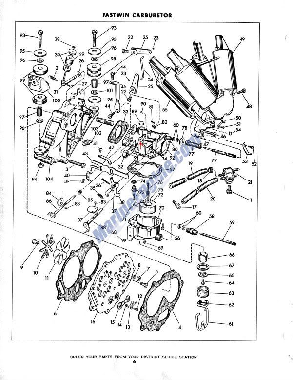

you may be confusing "seating the low speed needle" for the" needle valve and seat"? As you tighten the needle it does get tighter in that bushing and if you overtighten it will cut a band, or step, in the needle taper. To view the point of the needle you can pop out the core plug <#89> in your diagram and you'll see a small "well" with 3 or more holes which are drilled into the carb throat directly behind the throttle butterfly. These supply fuel to the engine at idle. The tip of the needle enters this well area and adjust the fuel ratio at idle. Looking at marineengine.com it seems 303945 was used in the 1957 18 hp. as well as the '56 15 hp. Were it cheaper I personally would take a chance on it. As kbait suggests, it's worth calling around to see if it'll work and if it's available used.

The seat is NOT a separate item and is NOT replaceable!! Fortunately, it rarely is necessary anyway.
The "bushing" is the threads for the needle to screw into/through.
Use common sense. As you screw the needle toward the seat, it closes off the hole (which the idle fuel goes through). Screw it in, less fuel goes through, and the fuel/air ratio is leaner. Back it off and the hole opens, allowing more fuel and a richer fuel/air ratio. In other words, it is nothing but a glorified faucet.
Now, understanding all that, even a damaged needle and or seat will open/close off the hole. The only problem is if damaged, it will be very touchy or very unresponsive. The one in the picture is terrible. That would be next to impossible to get right. Any attempt at repointing it can only make it better, because it can't get much worse. Worth a try.

Your part #89 is the detail you'll want to have a look at now. I find that an ice pick is the best way to remove the cap. Just don't tap to DEEP through it tho, you've got about a quarter inch below the cap to play with.
You'll see the 'seat' (at least the back side) there inside.
