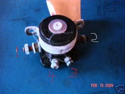

Re: ignition - does it need to have a direct connection to battery ?
solenoid is an electric switch, activated by the key switch. the positive battery cable runs to the solenoid and another cable from solenoid to starter.
you can see small red fuse holder in bottom right of the above picture.
