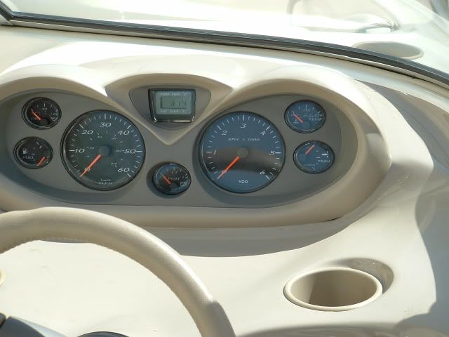

Well had the tach tested and sure enough it is the tach. QC you where right!! It is off at idle at about 500 RPM's and as the throttle increases the more it is off. At WOT it is off by almost 1200 RPM. They are going to check to see if they can order just the tach from Bayliner, but they say he wil probably have to get the whole cluster which will be an arm and leg we hear.
Ok so here is the next question can a universal automobile TACH work? He was thinking about mounting one in the engine compartment and keep the one in the dash the way it is instead of putting out all the CA$H. With one mounted in the engine compartment he will still have an accurate way to read the RPM's.
Well can it be done???

Cool!! Whenever we have negative slip (boat goes faster than the numbers theoretically allow) then I start screaming "tach". I would bet at least 25% of the time we get performance complaints here it is bad data, unrealistic expectations or incorrect operation as opposed to the engine or other mechanical stuff being wrong or messed up . . .
Can you get us a decent pic of the tach? Maybe we can do better than your dealer ;)

This is it.

Did he get in the back of that tach and check the 4, 6, 8 switch? If it is a percentage off I still suspect it is simply set wrong . . .
Hansolo99
Jun 27, 2009
302
Re: Is the prop wrong? 4.3 V6 Bayliner
He said he did but I cannot be certain. I checked and there are 2 different areas that can be adjusted with a screwdriver however I cannot see anything that says 4,6 or 8. Is there somewhere that I can see if it is something I can do??

If you can't correct with the settings on the back ( which you may be able to do while, running, but should do with KEY off )
And If Bayliner does honor a warranty replacement,
I would contact VDO for a replacement or REPAIR.. ( as they are the manufacturer )
I would not replace entire cluster unless you REALLY wanted to..
good uck.
QC
Mar 22, 2005
22,783
Here's a link to a VDO Tach Manual. Looks more complicated than a typical one, but definitely adjustable. I still suspect this is set wrong based on what you are posting. My guess is it thinks it's a V8 and reading correspondingly low . . . But that scrambles my brain, so I might be off and it is set for a 4 cyl and reading that percentage off which would be more of a percentage off i.e. 4 to 6 as a percent vs. 8 to 6 as a percentage. Tach should be off by one of those percentages if I am right . . . :confused: :eek:
