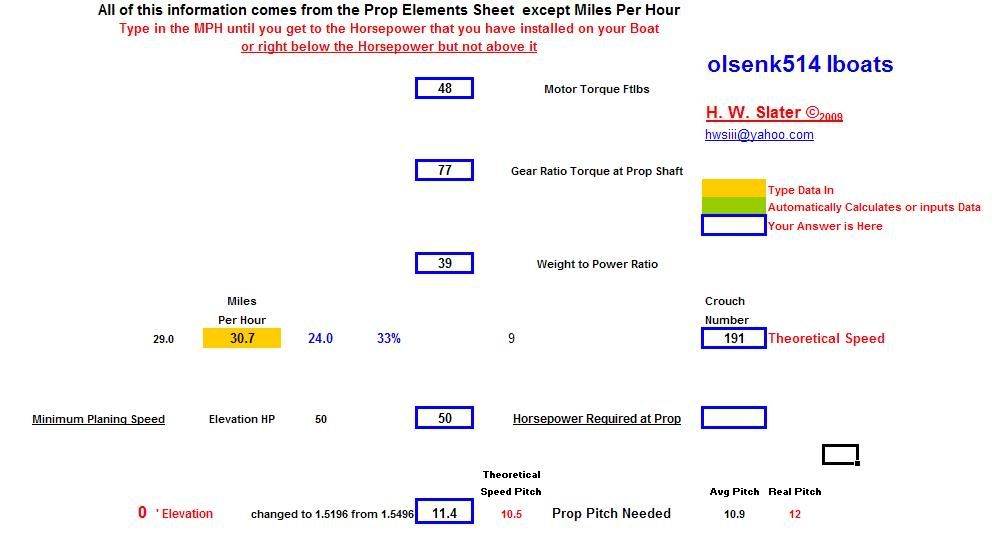

Olsen, I don't know what calculator you used, but your boat should do about 31 to 33 MPH at top speed. Your prop slip is right at 33% right now and that is your problem. Sine you do not have power trim, that also stops you from attaining your maximum speed, because you can't adjust the motor to the perfect sweet spot that it wants.
I would recommend you raise the motor as high as you can on the transom, with the motor tilted out to the second or third pin setting for tilt until you find the speed to come up to at least 27 MPH. I also would try and have the prop shop put about .5" of cup on the trailing edge to cut down your prop slip. You really would be better off with a 4 blade prop, but I can't find one for your motor.
If you try a 12.5" pitch prop in the same make and model of prop you have now you will lose right at 400 RPM and even have more prop slip than you do now as well as lose hole shot and acceleration.
Prop Pitch and Speed
Prop Slip
