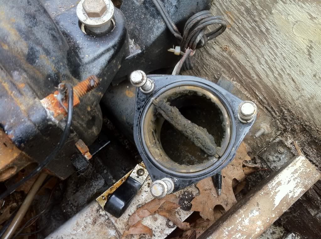

Is there where the exhaust shutters were? I found them in the Bellows.

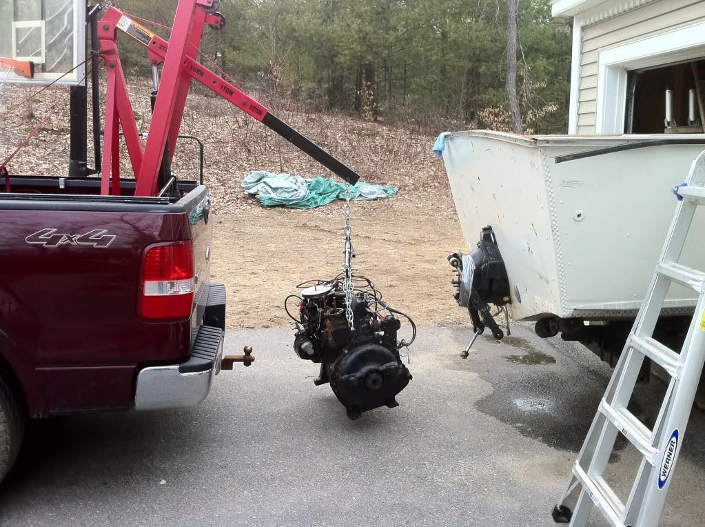

Engine and transom removal system. I have a patent out on this.

good plan on how to modify your hoist to do the job! but you have more confidence in those tiedown straps than i would....i'll steal your idea for the next engine install, but i may use 1/2 or 5/8" nylon rope instead......
Man I wish I had thought of that, getting my engine out was such a PITA that I could not believe it. And still need to pull my transom as well and I was dreading that. With your idea I am betting it would work big time. Did you have any issues getting the motor to the ground from the bed of the truck? Don't know if your truck is stock or not but mine has 36's under it with a 2 1/2 inch leveling kit on it. So am thinking that my hoist would not be able to drop the engine on the ground. But I really do like the idea of doing it this way. Thanks for the idea Reming870.

Great idea with the hoist in the truck. I?ll have to use that one next time. I would think that the engine would only have to go down to an engine stand and not the floor. If it needs to go on the floor then the two-step method could be used.

Plenty of room to the ground. I had the picker fully extended and there was enough room to get it to the ground. An engine stand would have been ideal, but right now its in the driveway on a skid. There were two more sets of straps on the base of the picker as well with a back-up chain. When I did pulled the transom we actually lifted the boat off the trailer at one point. That foam has some serious strength to it.

Oh yea, I can see that I would have to use the 2 step method that is for sure. My bumper is probably close to twice the height of yours so there is no way even with my engine hoist fully extended it is going to reach the ground. On the bright side of that is that I will not have any issues cleaering the transom once I do get the engine on the hoist. I am going to use this method to pull my transom that is for sure, I think that it is the only way that I am going to get the stupid thing out when it is time as I don't have anyone to help me lift it out of the boat and it is also a long ways up there. Keep up the good work bud.

Kelly-- two thoughts: 1. you could make sort of a "ramp" from tailgate to ground out of 2x12, 3/4 plywood, or whatever and slowly slide the old motor down. i did this solo and it worked fine
2. what i might do next time is make a simple crude-but-sturdy table from 2x4 scraps and the leftovers from your 3/4 plywood. then get some chain for a long sling for engine and lift it first onto table, then shorten your chain sling to minimum to hoist it over transom
Connect a chain hoist to the engine hoist. Use the engine hoist to lift the engine out then the chain hoist to lower it to the ground.
I'd suggest chain instead of the ratchet straps.
