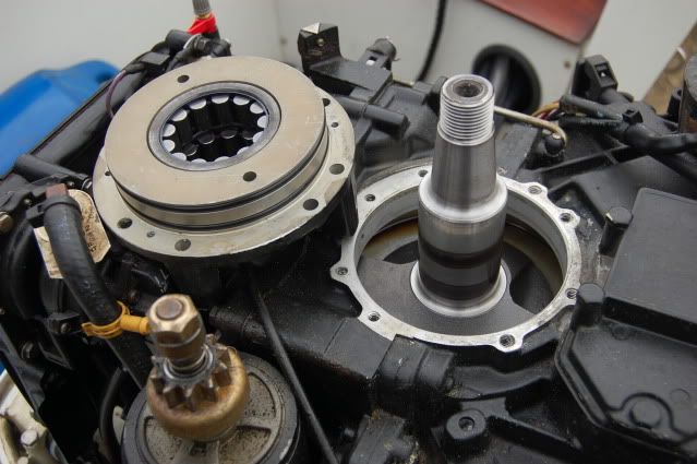

Ok everybody,
i managed to put in a new upper main bearing. Made a picture of the upper part, showing a slightly colored tap end of the crank, but other than that every thing looked fine.
The new bearing has also some radial play in it. I check this by wacking it lightly with my hand so you can hear the freeplay.
I do know that every bearing shld have play, otherwise it would not turn at all. Besides that, heat will expand bearing aswell, so freeplay is a must.
The question is always, is that play too much, or can we run it.
Anyway, took her out yesterday for a test run, and the gear noise at idle is less, but there is still some to be heard.
But haven seen this old bearing and the crank tap, i feel more safe for running this baby in wide open see.
I accept the fact that these twostrokes can produce some sound, so i don't worry anymore.
Here is a pic of the tap and bearing housing.
Btw i heated up the housing in the oven at 200 degrees celsius and gave it a slight wack after 10minutes. Bearing just fell out. Piece of cake.
Flywheel was a @#@& though. Had a heavy puller, but man is this baby tight.
