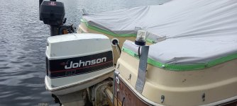

Hi
I have a 1984 Johnson 70HP motor which starts and runs very well with loads of water coming from the tell tale - until I increase revs and she starts to plane. She then stops taking water and I get steam. When I throttle down again she takes in water. The engine is as low in the water as I can get her and the intakes do not seem to be clogged. As I said, it works nicely with pressure at low to mid revs but when the stern rises a little she takes in air. Any info would be appreciated

Post a pic of engine on transom and when was impeller changed? Just cause it
'Pees" dont mean it cooling...

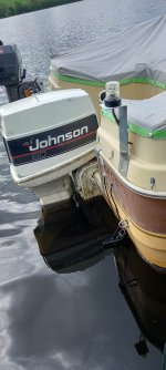

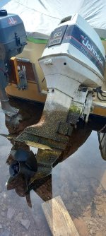

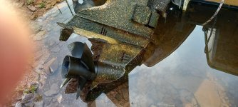

Here you go.

I suggest a new impeller and a good bottom cleaning. Growth on boat especially in front of engine can disturb water flow and cause engine to overheat .
