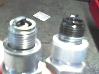

hi all, i have a 1977 johnson 9.9 and it has been running rough since i got it and i'm still trying to diagnose the problem...the motor will idle ok, its when i give it gas to go all it will do is bog down and not hit any rpms...the first time i checked the plugs the top one was clean and the bottom one looked fouled out..so i checked for spark and the top one was real weak...so i replaced the powerpack and cleaned the carb. and took it out and it is still doing the same thing...same for the plugs, top one was clean and bottom looked fouled out..i'm thinking coils now, but i'm no expert by far...carb should be ok, it was clean as a whistle...i checked the compression and its all good...i did notice when i took it out today that there was a weak "pee" stream...i'm going to replace the water pump, but would that have any effect on the issues i'm having?? Any help on what is going on here would be greatly appreciated!!! Thanks..
