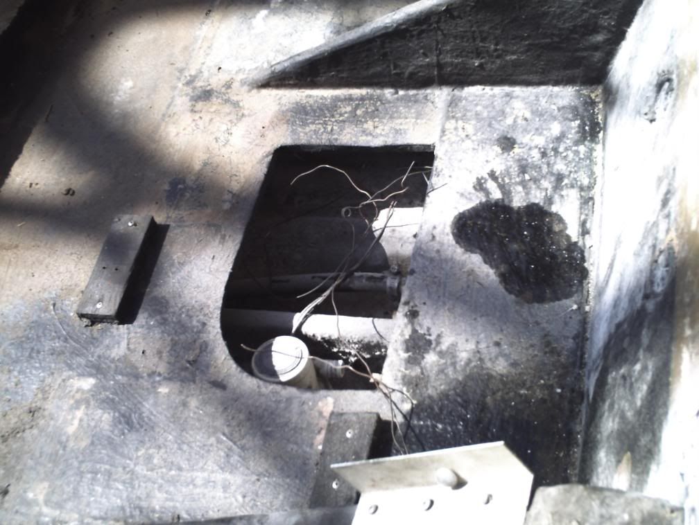

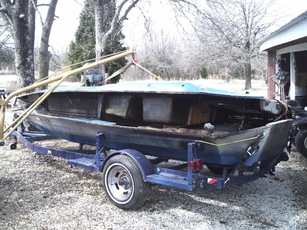

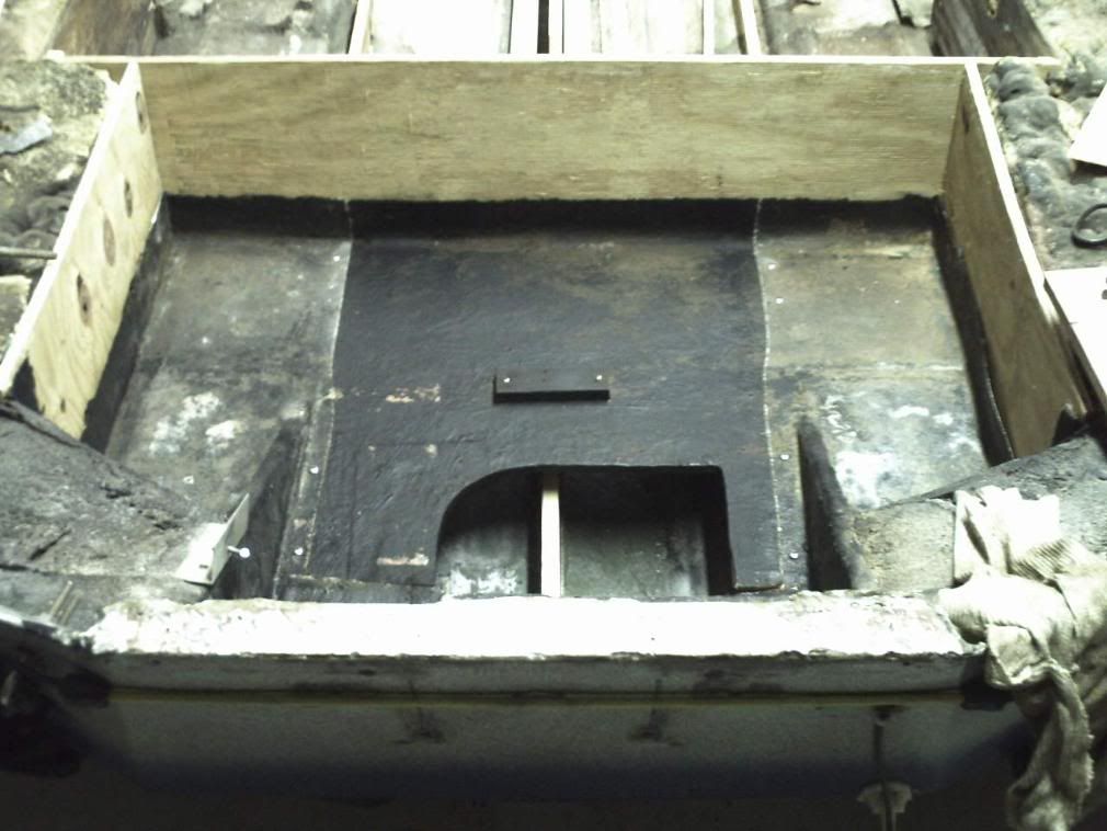

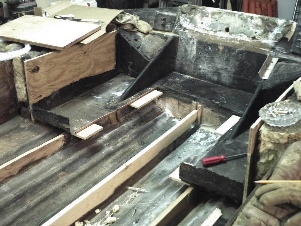

Well, here are some photos as promised in my stringer work on this boat. I removed the cap and all the stringer material. I installed new stringers and made a new floor piece that goes under the front deck for storage as it didn't have one before. I also replaced the little back piece that is located under the transom where the hull drains are as it was rotted too. I had to cut out the middle section of the deck board that supports the batteries and gas tank to get everything out. Suprisingly, everything is going quite well and smoothly. The only hold up right now is waiting for the weather to warm up some more in order to do the fiberglassing.​
I will send more pics when I get the chance.
