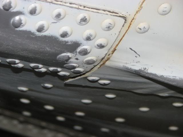

Well, i did more work and still have not found the source of the leak. I exposed the section where most of the leak APPEAR to be coming from. The seam looks good.
This is the bow w/ the deck removed
The water pours out below this middle section that I exposed
close up of the seam below/no visible damage
I guess I have to get under the plate at the bottom of the hole. The rivets go all the way through the hull. I'm nervous about drilling these out, but I guess it has to be done.

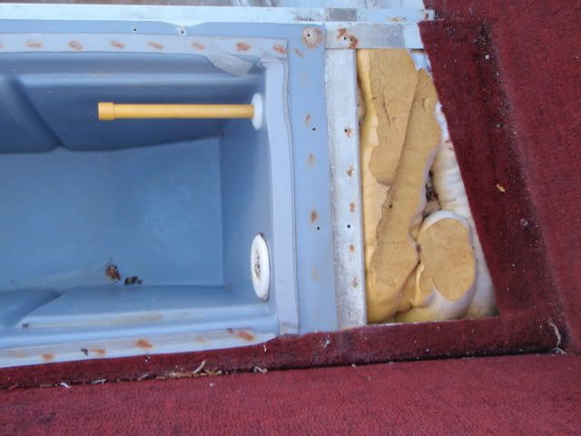

If I don't find the leak in the front section, next I have to get under my livewell. Not looking forward to that. Why mess with a perfectly good livewell?

If they filled the sides of the livewell with expanding foam it's going to be a PITA to get it out as it's essentially glued into the hull, need to hack the foam out and get out of the gaps and cracks. It looks like they filled the plumbing area with foam, so that's going to be fun getting the foam out around the hoses.

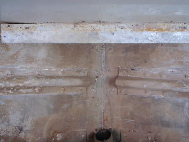

So anyway, The leak is not from the rivets, it's pouring out from the sides of the keel cap. From the inside of the boat, I got to the area where the water is pouring out, but I don't see any obvious damage. I guess I have to tear more of the deck out. Unfortunately, the next section to tear out is under my livewell. If time permits, that's going to happen this Saturday. If I'm going to go that far, I might as well re-do the whole boat. I guess this is an official restore.

Here's a shot of the leak....er....I mean water fall.
Here's the area just above where the water is pouring out. I was expecting to see a huge hole.
....and here's a portion of the livewell w/foam encased plumbing. Lovely!

Don't take it to a welder ! There is a rubber gasket between that keel cap and the 2 pieces that come down to form the v in the hull. You will melt it and have a worse leak.
This could be from grounding the boat.
I only suspect that because of the location.
You will need to get to the inside and see if any damage is there. If there is no damage you will need to tighten the rivets. Someone on the outside will hit the rivet with a hammer and someone inside with a metal block on the rivet. This will tighten it up.
Then check to see if you still have a water leak, retighten again if needed.
Then clean the whole area real well and put some GLUVIT on it and you will never have a problem again.

Lake I just enlarged your pictures and is that weld on the side of the keel ?
If that is weld on the keel ,thats why it's leaking. The heat melted the rubber gasket. Welding aluminum is very tricky with a boat. The aluminum is hardened on a boat and will stress the aluminum sometimes even crack it.
Also just google "GLUVIT" and you should see it forsale at many places plus the companies home page.
When you do that area with Gluvit lower your trailer so the bow is down some so it will seap into that seam. You will apply it from the inside.
Don't use epoxy use Gluvit because it will flex as your hull does and expand as the hull does in cold and contract with it when warm. Epoxy will not and crack and break off.

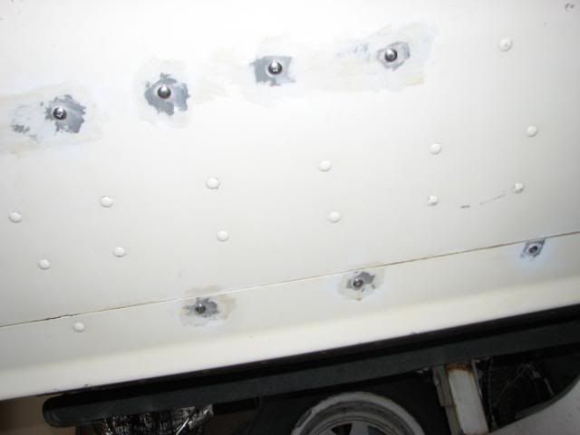

Progress so far:
Drilled a 3/4 hole in the inside cap covering the keel (my access is about half way in front of the gas tank). Lower the trailer jack all the way down, mixed up half a can of Gluvit and poured it in. Took the remainder of the Gluvit (its thick so it sticks to the side of the mixing cup) and coated the outside of screws I replaced/repaired and started a coat on the exposed keel plate (from wear.
Drilled out all blind rivet that I could get to and replaced with 3/16 Truss Head SS 18-8 machine screws, 4200 fast cure sealant, washer, nylock. Also drilled out 4 other OEM rivets and did the same. (None of this is related to the bow leak.)
3/4 drilled access hole for pouring in Gluvit.
Where my keel plate leaks.
Replaced rivets with Truss Head Screws, 4200 sealent, Gluvit.
I'm going to let it cure for 4 or 5 days and go dip it in the lake (on the trailer) to see if it worked.

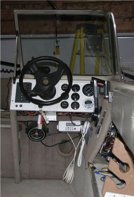

BTDTBTTS (been there, done that, bought the T-shirt) :D Trust me, it's all worth it when your sittin on the big pond sipping your beverage of choice ;) Keep you posted.
Console before
During
Console after - I had to make room for FishTV, didn't I.
Now, if I could only get rid of all that nasty carpet. Next winter maybe, it's to close to fishing season for now.

Why two sonars?
The boat came with a sonar and the other unit is a GPS, With the bubble dash and windscreen slant the sonar was right in my face. I replaced it with a big screen duo - Lowrance LCX 113c HD which require more room thus the console mod. I really wanted to get two seperate units - if the sonar quits you can always use your waypoints and if the GPS quits you will have the sonar to find fish - but it was to costly. I carry a old handheld GPS for backup with my major waypoints home (around the rock shoals/sand bars/harbor).
