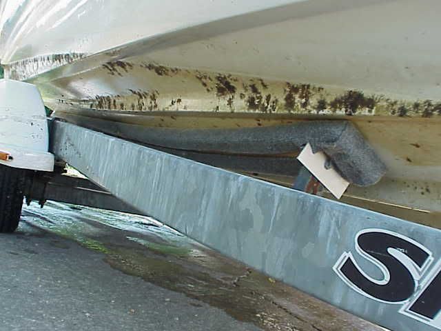

You don't live in Illinois or have a boat on any river in this state. Marine growth on the Illinois River is HORRENDOUS! (Did I spell that right.)
Here's proof:
This is after two weeks, not int he heat of summer yet:

Exactly smoking, see my photos above of two weeks growth in the Illinois River. Which has a chance to be very similiar to the original poster's conditions.
