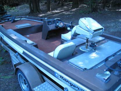

From the CL ad:

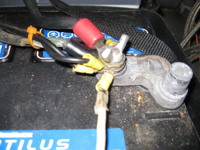

an original wiring pic:

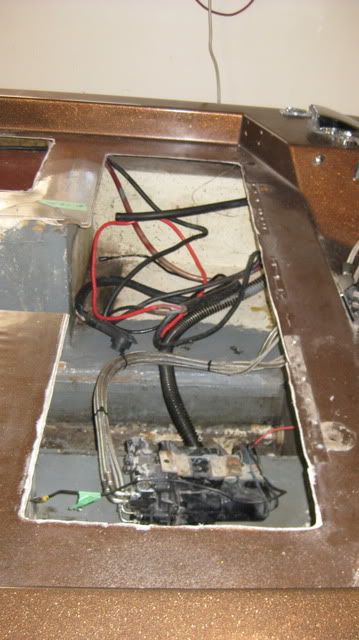

Tank/Battery compartment emptied out:

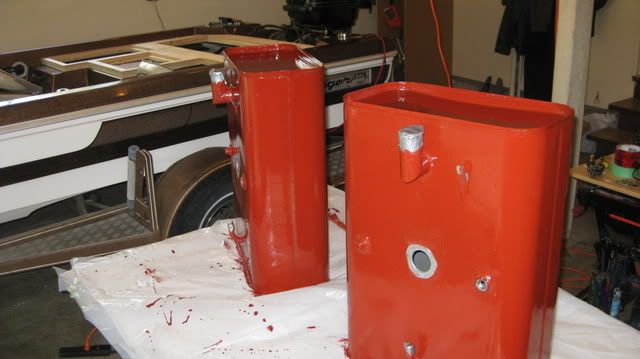

Gas tanks primed after POR-15 sealing of the inside:

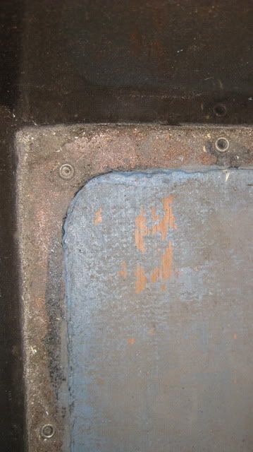

Pic of floor as it is attached now.... what to do...what to do.
