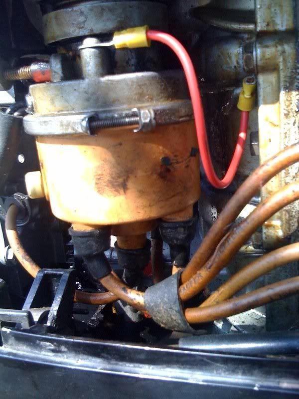

Before i move on with the carbs, i want to confirm im getting spark, so here is a stupid question.... What is the best way to check for spark? Batt is charged, Engine turns when i hit the key and plugs are new but after looking at the cap, i started thinking more about confirming spark.
