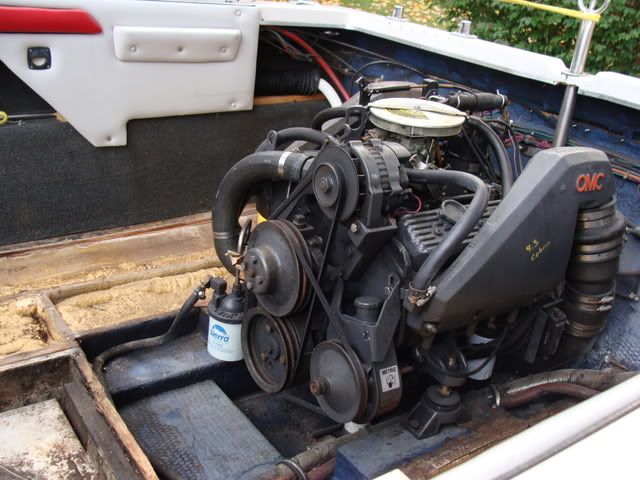

the side carpet is visible from the deck to almost all the way up to the cap. ill see if i can find a pic before i tore the deck out
skirsch68
HopinImFloatin
Sep 21, 2010
136
Re: looking for opinions on carpet seam
thats better, you can see the old carpet going up the starboard side
