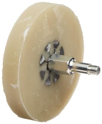

Rebel - I removed as much of the decals as possible using a tool like this: wheel. It was the easiest method I could find, but it did not remove everything. What remained was so firmly stuck to the fence that I just painted over it. The main reason I covered over the original decal area was to hide the irregular areas where I painted over it. The finish of my fence is pebbled, so the bits of old decal that remained under the paint do not show through on the new decals.
