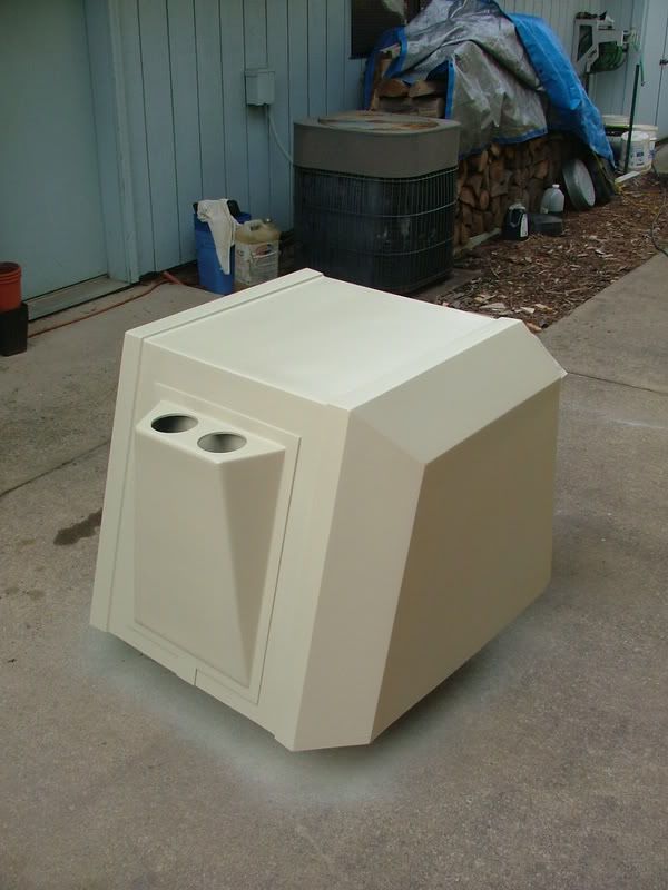

I recently aquired an 18 ft BeachCraft.
The front windshield is very misaligned and will not close. Upon close inspection, the top cap is constructed of chopper gun glass, no mat or cloth of any kind. As such it is very 'floppy' and the rear of the front deck has actually sagged, cause the dash extentions to droop as well. My first clue came when I redid the doghouse. It was constructed the same way and was way to sloppy. After I did the work on it I glued in 1/2" ply at the top rear and bottom front insides and that really stiffened it up.
Checking up under the rear of the front deck there is no real supporting structure to keep it in shape. I got a piece of 4 x 6, place it on the floor, took two bottle jacks and a 2 x 4 above and jacked the deck up into place. That took the droop out of the dash pods and realigned the windshield parts.
When time permits, I will scribe a piece of 3/4 ply to the contour of the rear front deck, raise it up under the deck and epoxy it to the lower side, then add some glass tape from the support board to the underside of the deck.
