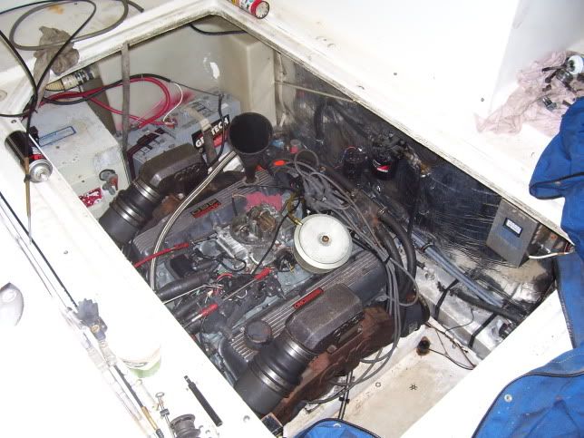

Yes Don, its all been tuned up. It had better be because the engine is a remanufacture and was just installed in early Aug. As for QC, Yes the RPM dropped as I was underway. It was "VERY SUDDLE", no bucking,or hesitation from the engine, which seems to rule out bad fuel filter or gas. It was if I were pulling back the throttle very slowly, and smoothly. It also did it at about 3000 rpm, dropping about 2 or 300 rpm. I'm wondering if mabey the cable to the cabarator was loose.
http://i76.photobucket.com/albums/j37/MarksJoy/b1d5491f.jpg

Sounds like a possible fuel problem. Check the fuel pressure to the carb. Here is a fuel system test courtsey of Don S.

Re: Lost Some RPMs
No, Salty, I heard the sound of the engine starting to slow down, and slowly I lost plane. When I heard the engine slow, thats when I looked at the tach. to noticed that the needle on the tach was going down. As a matter of fact, it was so suttle, that my friends on board didn't even notice it. No skips or jerks, or hesitation from the engine, it was a very smooth transition down. I think its something on the carberator that loosened to bring the RPMs down 600. At WOT, when I was able to get 45-4600, now I just make 4000 RPM
