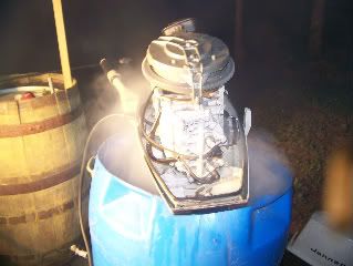

well i dont think this is due to "gunk" buildup, we had it running last summer and it didnt smoke at all.
Yes, its currently in a barrel, but there is sooo much smoke, i do not beleive its because of being in a barrel..
i will take a picture once my neighbors go to sleep, its almost comical....

alright, so you guys are saying that this is normal? this isnt exaust building up in the drum either, it starts as soon as the engine does. and the smoke is white...
(abut 3 seconds after i killed the motor)

Re: lots of smoke
Oh man, that is completely fine. You will not even notice smoke when you are on the water. Mine literally filled my whole garage with smoke and after a few good runs it was barely even there when I was out. You'll be fine. All good.

Oh yeah. That's fine. are those 2 cranky neighbours I see in the background? :)
