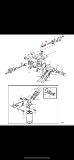

I have been told by a Volvo Penta mechanic, to look for 2 springloaded valves near the oil filter. One could be stuck in the open position. Therefore low pressure.
Sounds reasonable??
51,874
it could be possible that one of the oil control check valves is stuck. however that will require access from underneath the engine to get to the check valve. you will most likely need to pull the motor to get to it.

That would be the filter bypass, he is likely referring to. Not sure he is on the right track with that one.
Is there any sign of oil in the water out the back ? Oil in the bilge ? Have a good look around the bilge if you can. Is there perhaps damage to the wiring to both the gauge and alarm pressure switches?

I have got this from a Penta mechanic to day.
He told me to look at this. See picture.
The two parts marked in read.
