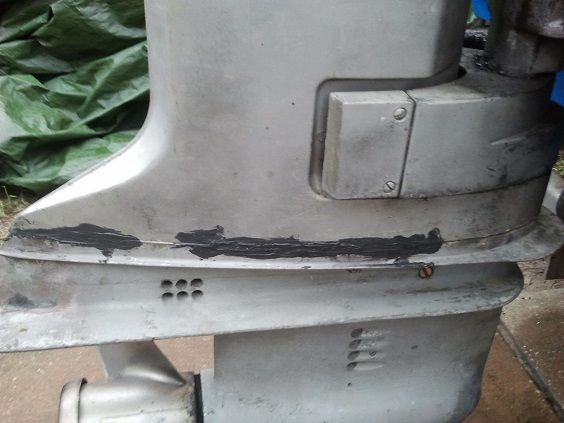

i got a 76 Johnson 115 V4 seahorse that has some water leaking around the bottom gasket where the foot connects to the shaft/motor when i connect the water ears.
it leaks water pretty good right above the foot there.
would this cause it to run crappy and have other problems?

im getting great spark and it runs great in the driveway with the water ears.. it just starving for fuel and ive rebuilt and cleaned the carbs which was easier than i thought.in the process of getting a new fuel pump mine was worn out.
so it doesnt matter if its leaking water out of this area bad?
someone put rtv on there at one point ..
hers a pic of where and what im talking about

i got alot of water leaking from that area with the water ears connected...should i fix this ?

i added a pic here to show up close there is actually a gasket there ..i dont know why but its there .

and where the waters leaking out is where the gasket is broke out and water pours out of these spots pretty fast.

By the look of the photos, someone also had the same thought as you (there should be a gasket) and put a load of silli stuff on it :facepalm:... There has never been a gasket used on that joint, by any manufacturer of any outboard I have ever worked on, not even the stern-drives have a gasket there...
If there's plenty of water leaking out, that's a good thing... It means plenty of water is getting INTO (the cooling system of) the engine....

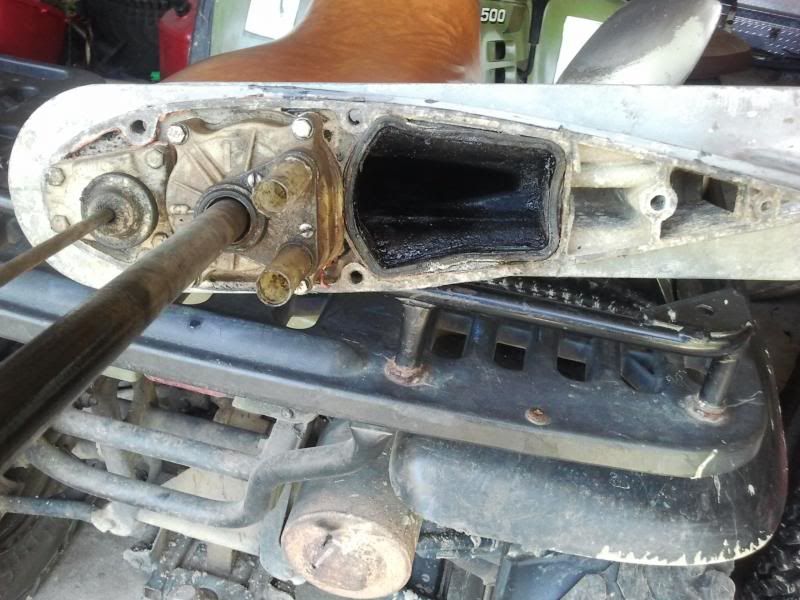

so i got the leg off and allk the gasket material cleaned off the mating surface..im gonna just put it back metal to metal.

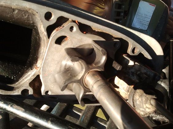

i took a pic of the impeller..do you guys think i should replace it?
please let me know it seems pretty decent no scratches on the fins to speak of.

oh and theres a exhaust gasket that went in there that was all messed up and pinched...should i got a new one of those?
you can see it in this pic.it had the same gasket on the mid section as well..is there supposed to be 2 gaskets like this?
and should i get a new one?

That impeller should be replaced, no question!
