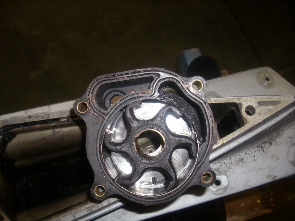

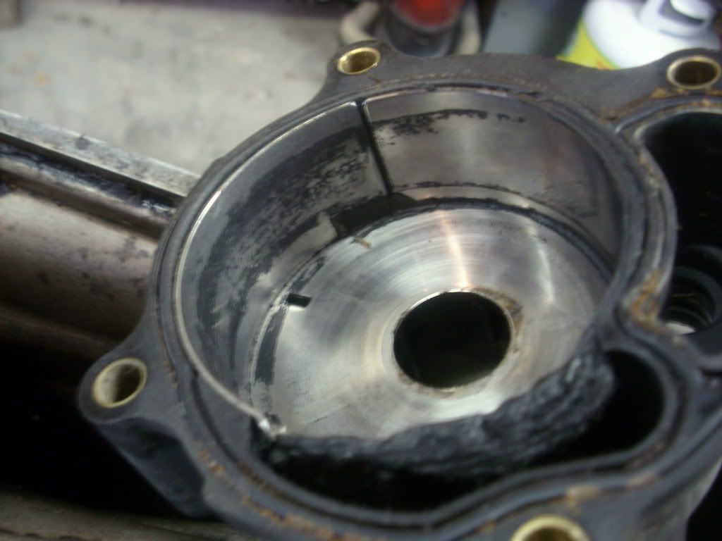

So I pulled the impeller out and as fate would have it.... the housing has some melting damage and the metal lining is rough, I took pics. But they are to large to post here
http://i246.photobucket.com/albums/gg81/84amceagle/DSCI0774.jpg
imeller seems normal.
http://i246.photobucket.com/albums/gg81/84amceagle/DSCI0771.jpg
So went a little further pulled the bearing housing and seal. There is minor groving around the housing on the bottom end about where the thrust bearing sits
http://s246.photobucket.com/albums/gg81/84amceagle/?action=view&current=DSCI0775.jpg
Should I be concerned?
I think I better order a new housing tommorow.
wilde1j
Apr 15, 2002
5,964
Re: Lower unit removal on 135hp evinrude
Install a complete water pump kit ... don't try to salvage junk.
4barrel
Nov 22, 2007
46
Ya I know I've gone this far don't cheap out now....
The kit actually doesn't come with housing....
but got all the new seals and such to redo the bearing seal & impeller water inlet and outlet seals.
Got a housing on order, but going to see if he has a good used one tonight.
