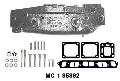

I am currently building a motor it is a 2.5L 120 Mercruiser from 1964-1972. It has a Rochester Carb. The Intake listed is MC-1-63122 or 63122A14. My question is can I put the MC-1-95862 intake on it. Both are 6 bolt so I do not see an issue with it however I was wondering if anyone has tried this. The reason for attempting this is I need the 45 degree riser for the new boat that I am building and I just spent a lot of money rebuilding this block and head. Thoughts???
Ayuh,..... Welcome Aboard,..... If all the bolt holes line up' it oughta work just fine,....
If you need the choke stove, just convert the carb to an electric choke,.....
