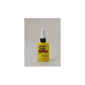

What about rear view mirror glue?
Slip Away
Lieutenant
May 11, 2010
1,431
Re: Marine Adhesive for Hatch Cover
This product needs UV (ultravolet) light to adhere. The sun is a good source. For best results the glass needs to be clear enough for light to pass through.
This product works best on non porous materials.
