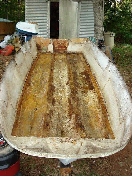

I'm thinking about doing the foam after the leak test but before the deck goes in. If I cut a piece of scrap plywood and cover it in plastic (so it won't stick). I think I can pour the foam in sections moving the scrap piece as each section is poured. I've never worked with the stuff before and I'm concerned about it popping my deck off or having voids that I can't see.
These 3 channels need to be filled. It's very shallow at the stern and gets deeper and deeper towards the bow.
And yes there will be beer or sweet tea, which ever I'm in the mood for.:D

sweet tea, with real sugar, a good southern boy. or you could pour your foam, and trim off the top, before you do the deck.
