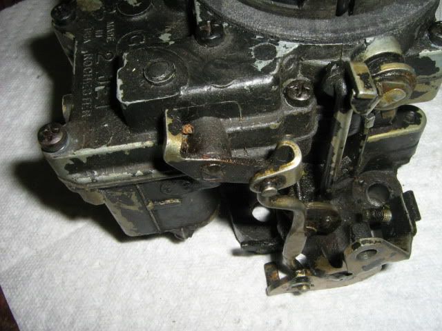

the screw on the bottom right is the idle speed screw (all ya can see are the screw threads of the screw in my pic). it's on the same lever that the throttle cable attaches too. normally it rests on the cam. when turned, it slowly opens the throttle plates. item 51 are the idle mix screws..

Hey ziggy thanks for your help I found it.But now problem is that the idle screw is not long enough to open up the idle,it needs about another 1/8 of an inch.Is this a common problem?What should I do?

..then the cam has flipped around...some one been working on the choke...:rolleyes:

ok, now i remember my sequece of events and why it's not happened to me for a while. that cam can flip onto the wrong side. when i rebuilt my carb. i rebuilt the one off my trisonics L6. so i don't have the carb on my boat that it came with. it's in the basement. i just went and fliped the cam onto the wrong side. it put up a little resistance but it did flip to the wrong side. w/o looking at it to close, i'd think worn linkage holes or pivot points allows this to happen. i know it's not supposed to, but it does on the one on my bench and i remember it happening when it was on my boat too. i believe my first sign was the choke worked improper and thats where it lead me. flip the cam back and i was hip. perhaps this has occurred with the op too.
the screw needs to be pointing at the curved side of the cam. not the back side. if the screw is pointing towards the back side of the cam, it won't reach. the screw should be pointing towards the curved part of the cam. the choke linkage would come down on the starboard side of the cam and looks sraight up and down. if the choke link is tilted to port at the bottom where it connects to the cam, it's fliped over...
if ya want a pic of what i just said, let me know. i can probably snap a few off for ya..
