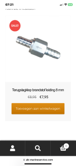

Hello I am new to the forum. I am from the Netherlands so forgive me some textual issues… I have the same issue, empty carb bowl after 3 days. My idea is to mount a return valve in the fuel line, see attachment. What do the forum participants think of this? Thank you for your replies, Karles.

You probably already have a valve like that at the tank outlet to prevent siphoning. So adding another one is not likely not solve your problem.

Ayuh,....... Welcome Aboard,........ I'd sooner think, you have a leak in the carb float bowl, as gas can not flow uphill past the needle seat to get back to the tank,......
Rebuild yer carb, paying close attention to any welch plugs in the float bowl,.....
Tanks, I indeed read somewhere that the standard valve is in- or close to the fuel pomp. This valve is already 25 years old, so maybe out of functionality (?). I thought that an extra valve in the fuel line will not do any harm.
the valve is in the fitting at the top of the tank pickup. its a spring-loaded metal check valve. mine in the boat was over 38 years old when I last checked and working perfectly. that is well over 1500 hours of running thru that little check valve. other than dirt in the tank plugging them up, they generally do not fail.
since your carb is dry, the primary culprit will be the welsh plugs. however fuel will evaporate out of the carb over a period of 2-4 weeks depending on air temperature unless the engine is overheated, then that period of time reduces drastically
