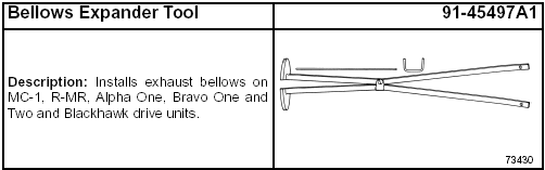

If you don't have the drive removed you will probably have to remove it. It can be done by hand but it's a pain in the ........ I use one of these. They cost about 50 bucks.
Exhaust Boot Expander Tool

Thanks for the advice. I do have the the drive off. Now, where can you get one of these expanders?

Thank you for the advice of the expander. I wasn't able to purchase one without waiting around three days, so I took the idea of the 50 dollar expander and made a facsmile of one with a 1.29 bungee chord. I expanded the bellows by hand, then wrapped a bungee chord around it inside the housing. This kept it from coming back and gave me the slack I needed to clamp it to the flange. Thanks all!
