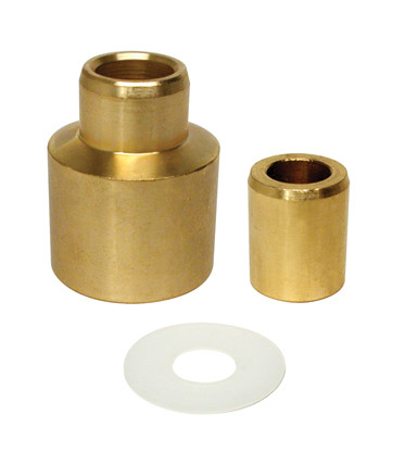

The new replacement kits from Merc or Sierra are bigger and come with the bushing. The seals are larger and hang down in the exhaust passageway. They last longer that way. That is the only way to go as they last for years. Drive the whole bushing, up or down, to get it out. Then I use a long 3/8" bolt up from the bottom, once inserted, you add a nut and washer on top to it as the new bushing with seal driver.
Old one on right, new one on left
Thanks for the help. Only I didn't understand this line "you add a nut and washer on top to it as the new bushing with seal driver." I think I get what you're saying but not quite clear.
Use a bolt as a homemade puller to pull the seal into the housing. Put the bolt through the seal and housing, slide a washer and nut on threaded end tighten the nut to pull the seal into place in the housing. It will be a light press fit. you can’t use a seal driver or socket to push it in as there is no access .

Merc makes a tool specifically to drive the bushing in. You can do the same thing with a longish 3/8th inch bolt, with a nut and washer. Insert bolt through bottom bushing, add nut, top that with a washer to protect bushing. Set bushing on threads and drive up into housing.
