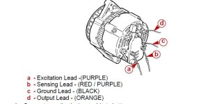

The Black is a ground, and I would install it under one of the nuts holding the slave relay in place. It may have been removed before and not reinstalled. Could have also been at another location, but it needs to be grounded to the block. With a bad ground it can cause the ALT to over charge
Looking at your pic, it looks like the Red and Black wires are swapped. If it is then the Bat was shorted to ground. Your motor didn't come with the 90 or 120 amp fuse, otherwise it would have blown first. Might want to install one on the orange wire. The fuse bolts to the starter post, then orange wire gets attached to the smaller post6

Your number 2 should be ALT to Bat (orange wire) from where I see it being a Mando ALT

Guess I don't understand the comment. The pics above "are" mando ALT
Here are different ones including 2 different Mando's
