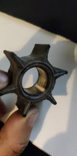

So a uppdate, the impeller was round so that was the problem, i put everyting back and try starting it and it was rly smooth and ran really well. I went to the dealer got a new one and when i was about to install it, it dident fit, even the mark seems wrong and the size aswell.... So i linked the pic, i guess that this is a diffrent axel and i need a smaller and diff fit impeller maybe you guys can tell

Part # of the new impeller ?-----Looks correct to me.-----Vanes on new impellers are not bent like old impellers !!
39,233
18-3007 or factory 47-89983T ??----Factory is best option in my opinion.----Which one did you order ?-----And yes you have to bend the vanes to get them in the housing !

So more updates it was the right one but i was missing a sprint, i put everyting back aaaand it worked sounds alright well its old so i dont know some sounds are prob someting loose or you know but it works but i think i messed something up with the brackets for the shifter and now i only got Forward and not revers haha but i will make a post about that in the fall for now its running and will take me from a-b so im happy
