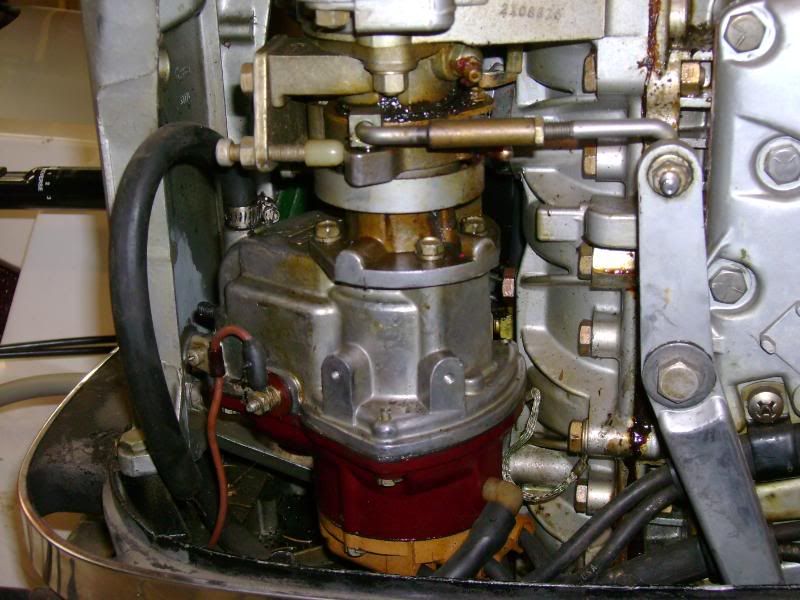

Now i got some pics of the loose hose.
Took some days, as other more important things came up...
Welll..
In the pics, you see 2red arrows. The one in the bottom, is where the hose connects, and the upper one, shows the hose just hanging freeely.
After some investigations, and talking to other ppl.
I found out that in front of the enging, just between the fuelconnection there are 2nipples.
The other hose from the ignition goes there, but the other nipple isn?t anything connected to.
When trying to get the lose hose there, it clearly looks that someone tamperred with this before, cause the clamps that holds the hose were on the wrong hose.
When switching these, the hose connects fine to the nipple in front.
can anyone plz confirm this? That the hose should really go there!

That dist, or magneto vent hose, on many older Mercury motors attaches to a fitting under that bracket where the first arrow ends then vents outside the enclosed powerhead, below that grab area.

Ok here is a picture of my engine so you can compare. I dont see that hose in my motor though.
