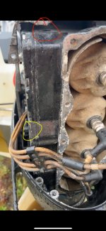

I took it out for a test run and noticed the motor running pretty hot to the touch and the tall tale was extremely hot.
I noticed on the exhaust manifold(baffle?) there was a brass cap and on the bottom of the exhaust cover there was a fitting with a hose that was capped. Should these be connected together? My tall tale is connected where the spark plugs are to a fitting there.
I opened them up (water jacket?) and didn't notice too much junk but cleaned them up afterwards but haven't closed it up yet.
As for the test run, I feel like my throttle cable needs adjustment I couldn't get past 2000 rpm and was bogging a-bit so I pulled the carbs to clean. I downloaded the service manual but cant seem to figure out what those 2 areas are for any help would be great
anyways on the picture in yellow was a hose that was capped and the red on top had a brass plug (is that used to flush? or should those be connected the yellow bottom one when i ran it in a barrel and took the cap out of the hose it had water coming out

when you replaced the waterpump, did you replace the tube seal at the bottom of the power head?

i had that taken apart and had some issues getting the copper pipe to fit.. possibly could of damaged something there... while putting it back together but i know for sure its seated correctly. not sure on condition of the seal

The Teletale connection point has moved around on some engines over the years. I have seen them located on the Water Jacket Cover, near the Spark Plugs, I have also seen them on the top of the Water Jacket.
Which Service Manual did you download?

As for the tall tale it’s hooked up from the back of the spark plug plate. Should I keep those 2 “ports” capped then ? Ones on the bottom of the water jacket and one above on the motor by the flywheel in the back like in my picture mentioned

What should I do with the 2 ports on the top and bottom of the water jacket should I tie those into where the hose goes to the tall tale ? Or loop the bottom and top of the water jacket side together?

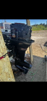

Post a Pic of the Cowl Top and Wrap.

Here’s the cowl and wrap and carbs that I cleaned

jimmbo
May 24, 2004
14,097
1968
Edit: 1969 would have had Merc 800 on the Side of the Top Cowl towards the front. 1970 and 71 would have had 2 thin Red Stripes above and below the word Mercury on the Cowl Wrap

Yeah it says merc 800 on one of the sides.. so is it a 69 then?
What are your thoughts on the 2 fittings should I leave them capped? I’m going to fire it up tomorrow and see if it’s still peeing hot after cleaning up the water jacket. I just didn’t see any water last time coming from the top just the bottom of the spark plug side that’s why I’m curious if they need to be connected but it should feed internally from the one side to the other I noticed on the plate there’s a hole.

You really need the Factory Service Manual to determine where the Teletale gets its water from. I will assume that someone has been in there and added a fitting at the top of the Block, or that was where the Teltale went originally as the fitting at the middle of the Waterjacket cover, was where I would hook up the Water Pressure Gauge Feed. As for the Fitting on the lower part of the Exhaust Cover, I have no idea what that one was about.

Those all look very similar. Is there a serial number that’s not off the swivel bracket I can find? Since I had to replace that and it’s probably off a 72 that I picked up
Added a pic from before I replaced broken cowl support bracket.
Edit: 6386A4 Mercury 1975-79 & 1985 Swivel Bracket
