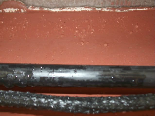

Thanks Guys..... I'm talking the top deck (cap) Getting it off seems easy enough. Getting it back on is the real challange. Here is a pic of the stuff that was used to "glue" the cap on.

First order of business is to remove the aluminum rub rail by removing the screws or drilling out the rivets that are holding it on. You might be surprised at what you find once it has been removed.

Had the rub rail off.... It's held on with what looks like #8 x 1'' round head screws.... These only go into that "stuff".. Nothing else beneath the rail. Weird Huh? I gotta assume it's some type of resin that was used as a glue. I can take a section off, if another pic would help.

Soooooo..... how does the top cap fit over the hull? Does it extend out over the "Crap" or does the "Crap" encapsulate the topcap?

I think in this case, "a picture is worth a thousand words" I'll pop a section of rub rail off and post some more pics. I'll also see if I can get a shot up/under the gunnel. Sure would be nice to figure this out :confused:

Here are more pics..........
I have the rub rail off. No more fasteners.
Here is a shot looking up. Also you can see the top deck's fiberglass lip
You can see how much more the deck cap hangs over the hull
This pic is inside the cockpit looking up at the gunnel
One more.. You can see where some of this stuff has oozed out between the hull side and the top deck
So, this kinda leads me back to my question. Has anyone ever taken a deck off a MFG? I'm stumped!

that is a flange joint.......yuck.......
the flange joint is glassed on the inside......i have not ripped one.....but just keep pulling stuff apart till you know how to get it done..... im farly sure there is a layer of glass at the joint on the inside.

A Flanged joint...hummm. Are they common? At least now, I know what I got. Do you think the white stuff is resin of some kind? This stuff looks like swiss cheese with all the air bubbles in it. Also it is fairly thick, and I don't see any fibers in it.
